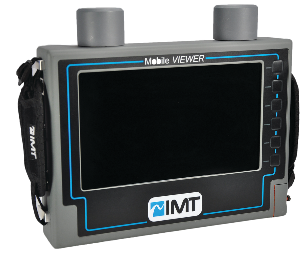

IMT’s CTVK includes the Mobile Viewer Receiver, a dual-input, COFDM diversity receiver with integrated antennas and a rechargeable battery. The unit is designed with an LCD screen, along with a GUI, for handheld operation. It offers exceptional RF performance with superb H.264 or MPEG-2 decoding. The unit displays video on a built-in, internal nine-inch, 16:9-format, high-brightness-resolution LCD display. Much more than a COFDM handheld receiver, the Mobile Viewer can send video over Ethernet to remote software or hardware decoders. This allows multiple remote viewers to monitor the same video simultaneously.
