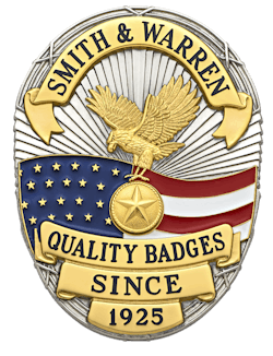

This gives Smith & Warren a unique benefit since police departments desire uniformity. The machine enables them to make every badge for a particular department exactly the same each time they order, even if orders are submitted several years later. “For example, if we engrave the word SERGEANT on the top panel of our S91 (pictured at left, middle shelf, center) we save that layout and do it the exact same way (lettering height, lettering spacing, etc.).” The company employs an advanced computerized electroplating line, ensuring the exact and right amount of plating is applied to the different finishes.
