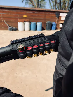

Mesa Tactical Sureshell Shotshell Carrier

The 590S is the perfect candidate for 1.75” shells, which work well in law enforcement applications. First, this Shockwave holds 9+1 of them. That’s a lot more capacity than most shotguns with magazine extensions. Second, I added a Mesa Tactical Shureshell Shotshell Carrier, which adds six rounds.
The Sureshell Carrier is made of 6061-T6 aluminum, or Polymer. It comes in 4, 6, or 8 round configurations. I picked the polymer six-round version with the integrated Picatinny rail. The polymer version is precision moulded, glass filled nylon, and they have a rubber friction retention system. Unlike similar products, the tension on the shells is adjustable, and users can play with it a little to suit their training.
The integrated Picatinny rail gives the Sureshell Carrier enough room for an optic, so I originally mounted an optic on my 590S. I found that the bead sight works best in engagement ranges under 20 yards. I strongly recommend a laser, and the Crimson Trace LS-250 is a good fit.Streamlight TL-Racker
